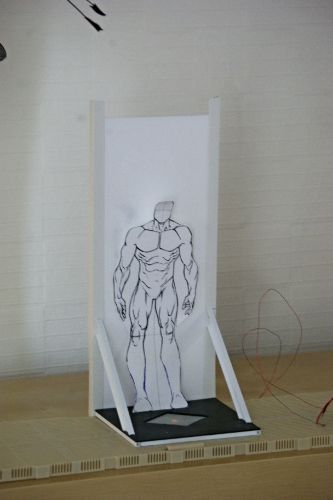

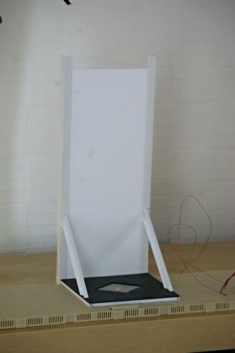

Working afternoon's today so time to start my Borg Alcove.

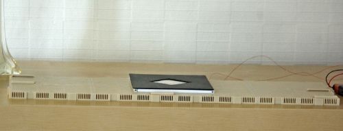

The base is two fish tank filter trays in which turned the right way hold gravel inside. There will be another two to place in front for the walk way.

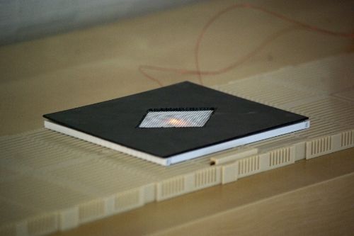

Starting off with the base of the alcove, I cut and laid 3mm square end plasticstruct rods, and placed a 3mm yellow LED in temporary position as an up light.
Using 1.5mm black styrene I drilled out, then cut out a diamond shape in the base plate. On the underside of the base plate I used a piece of Aluminium mesh from a car repair shop and a piece of opaque styrene to detail the base plate centre.
I need to have the up light illuminate more

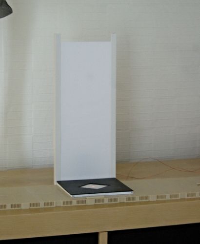

Using a cut sheet of white 1mm styrene, I re-enforced the sides with right angled beading. I secured the bottom to the base with some flat head screws

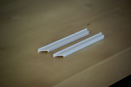

To make the base support beams, I used more plastistruct, I cut two "H" bars, cutting them at 45 degrees
Glueing them into position was quite tricky. I used a mini spirit level as a support on the back of the alcove wall to hold the structure at 90 degrees whilst holding the support beam
Getting this far, it is always good to cross check with the blueprints and the representation of the drone which will be sculpted

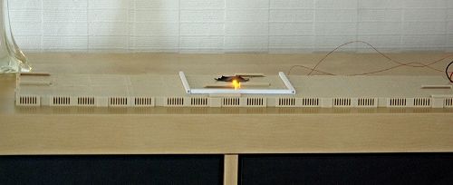

Next I turned my Attention to the overhead lid. I used some smaller gauge "H" bars, measured with the blueprints. I cut out the slot in the front piece and placed a strip of aluminium mesh in the back
Thanks for looking, more tomorrow!
Bill
