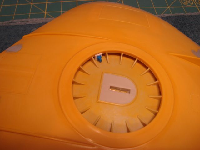

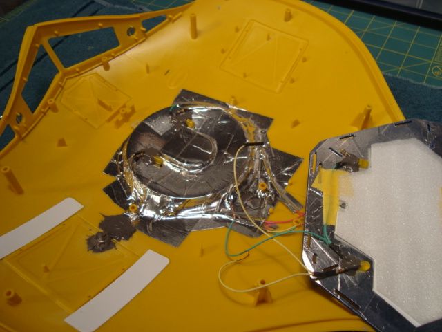

A bit more here for this week Guys.  The floor turned out to be a real PITA to light.  It pretty much rests directly on the docking ring, which of course runs right through all three hexagons  :'(  As a result it's very difficult to get it lit, let alone with even light.  :(  Ended up putting on some very thin sheet styrene to diffuse the light and hide the ring.  Also added some thin foam packing sheet to give a bit of clearance as well as help diffuse the light.  I put down some foil tape to light block and reflect.  The results are not 100%, but I did my best and that's gonna be that!!  I'm moving on!!  I neglected to get a pic of it when it was wired up for testing, but I'll put one up in a future update.
I want to have the power source on board.  This means battery power.  Therefore, access will be needed to change out a dead battery.  This little chore went amazingly well.  :)  There are hatches molded on the underside of the hull...I presume for landing gear.  I cut one of them out and rigged it to go on and off easily.  Worked out very well!  :)  The switch went in beautifully too.  I rummaged around in my "switch drawer" and found a nice little push on-push off switch.
Anyway, a picture is worth a thousand words, so here we go.
Here you can see the cobbling explained above, on the underside of the floor and the lower hull in order to get some light coming through the hexagons.  Did I mention this was a major PITA?!!

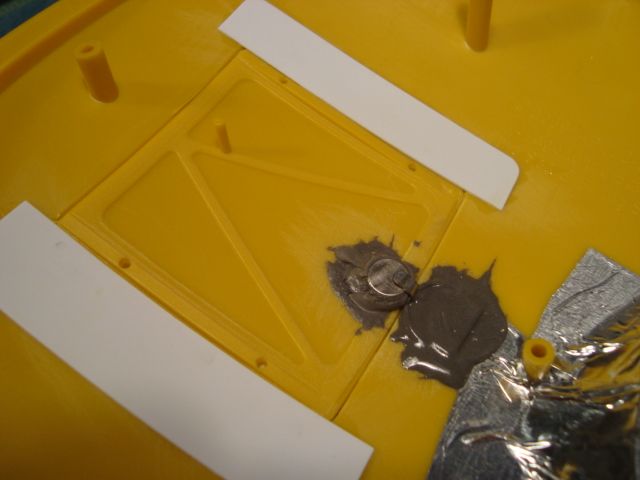

Here's the battery hatch.  A metal tab was epoxied to the hull and a magnet to the hatch.  Some strip rails were put on the sides of the opening to keep the hatch flush.  It sits very nicely and goes on and off like a champ.  I'm really happy with it.  I thought it was going to be a struggle.

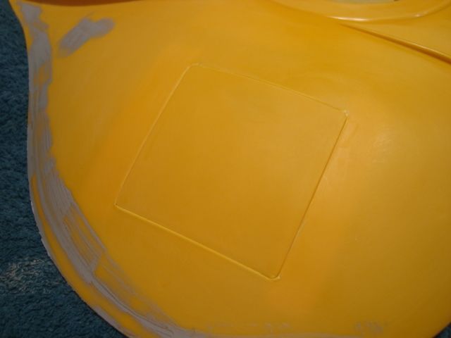

Battery hatch sitting pretty and some bodywork down.
I carved out a spot for the switch and a hole for the wires to pass.  It's a friction fit so it can be very easily replaced if needs be.  (That means it'll work forever!  If it was epoxied in, it would fail for sure!  ;D)

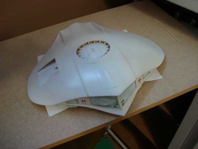

Last but not least, some primer down.
