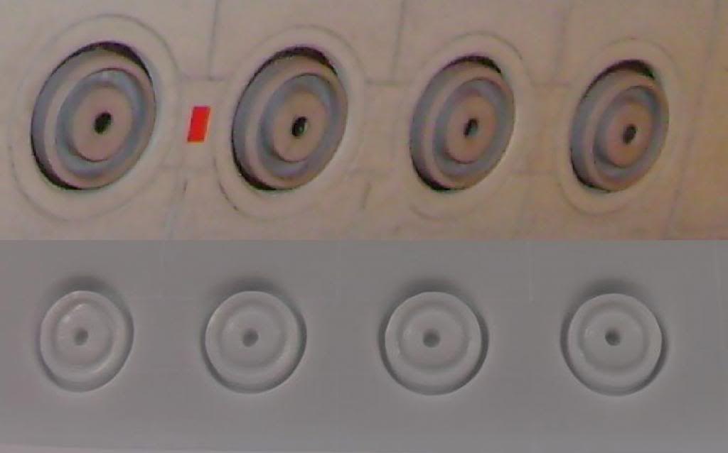

Studio VS Kit - devil is in the details
Here are the plasma vents with the studio at the top and the kit at the bottom. Notice how "soft" the kit parts are vs the crisp lines of the studio model.

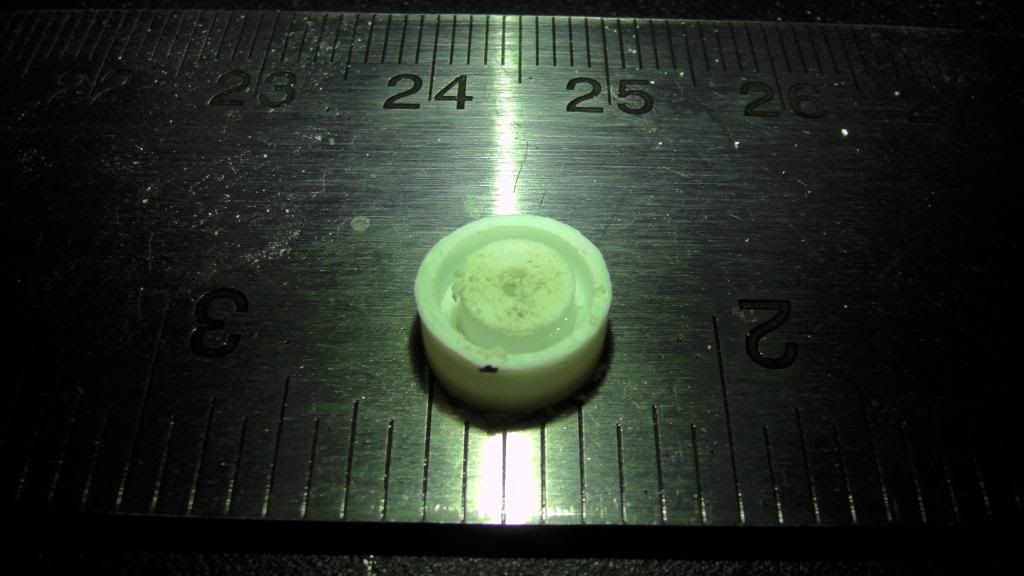

Lets fix that problem. Just like the brass tubes nest inside one another so do the evergreen polystyrene tubes. Here I have added a stop to my miter box and found the best size for the outer tube.
Here I have 4 pieces of tubing and some putty to smooth the seam between the innermost tubes. I cut and assembled several to get a good master for casting.

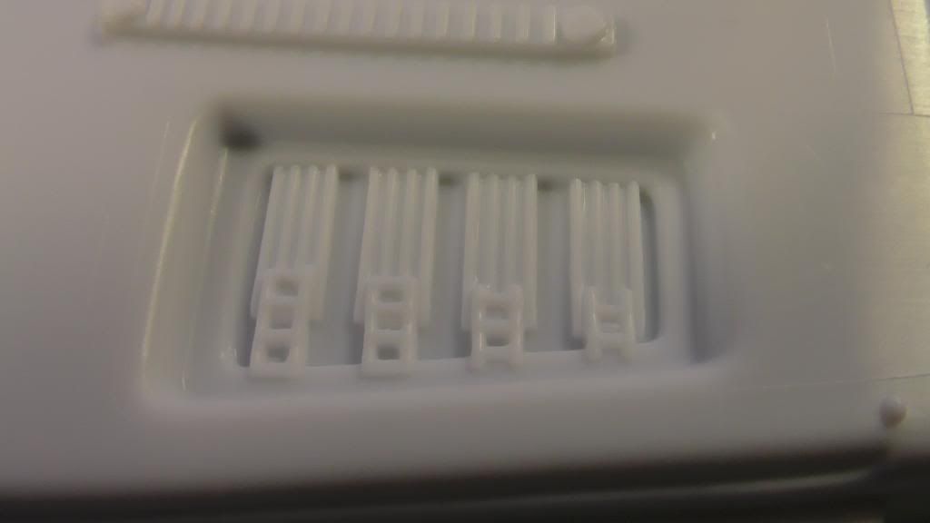

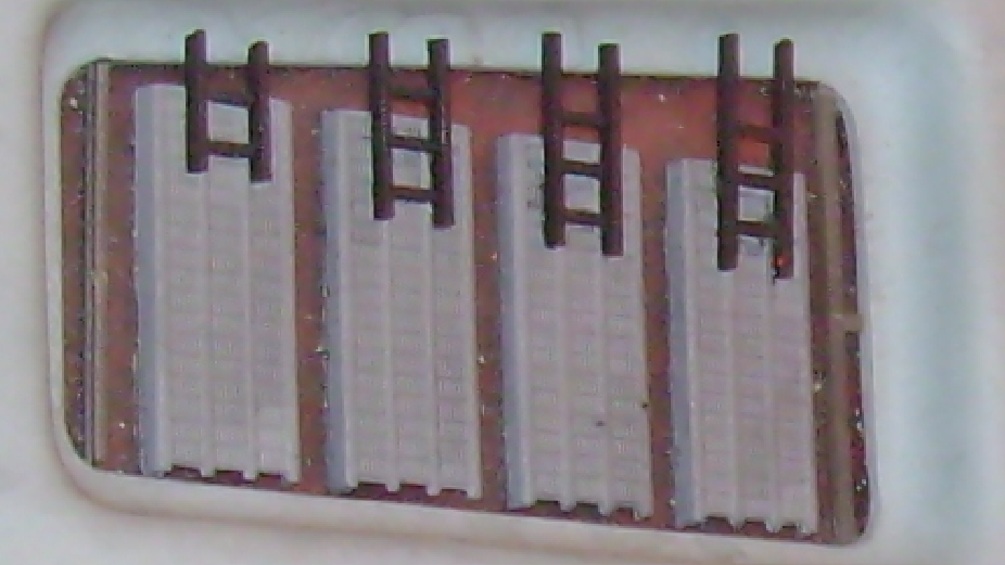

Another area that needs attention is the "grids". Here are the ones on the studio model
And here are the ones on the kit. On the studio the grids "float" surrounded by the red area, and the ladders are separate parts.

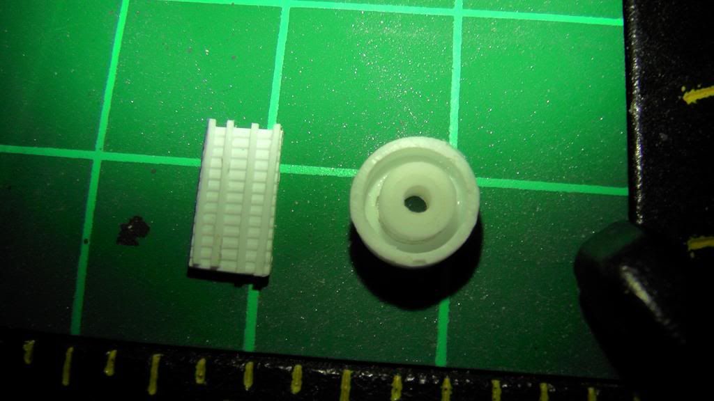

Here are the replacement parts ready for casting
