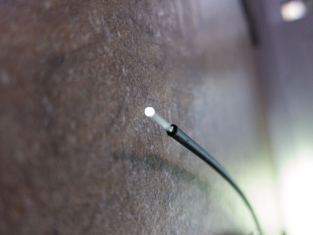

Hi, Everyone.
The other day I was thinking of ordering a 1mm diameter fiber optic cable when suddenly I remember that I have some extra TOSLINK (Toshiba Link) cables laying around.
For those who aren't familiar with TOSLINK, it is a standardized optical fiber connection system.   Also known generically as an "optical audio cable" or just "optical cable," its most common use is in consumer audio equipment, where it carries a digital audio stream from components such as CD and DVD players, DAT recorders, computers, and modern video game consoles, to an AV receiver that can decode two channels of uncompressed lossless PCM audio or compressed 5.1/7.1 surround sound such as Dolby Digital Plus or DTS-HD High Resolution Audio.
Anyway, a TOSLINK cable usually has a 1mm fiber optic core.  Just use a wire cutter/stripper to pull away enough of the protective covering to expose the amount of core you need, and there you go!
Good stuff!  :)

This is an awesome tip!  Thanks!!

That is a cool tip and reminder to some of us that might have such cable laying around Kenny....
